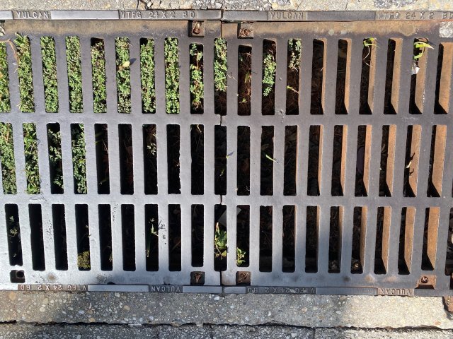

Same boat...2023 Pali Calli AWD...ANYTIME i GO OVER THIS GRATE abs ENGAGES NO CONTROL OF VEHICLE, NO BRAKES...AT DEALERSHIP SECOND TIME... grate2.jpg
